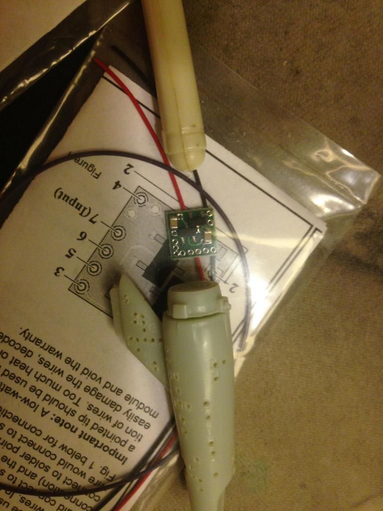

Post by slawton » Wed Sep 24, 2014 2:11 pm
I haven't made an update in a while -- I've been working 60 hour weeks since the beginning of August (but this is my last week of these extra hours). I was hoping to scramble and get the project completed by the due date, but I'll have to overcome some hurdles.
I recently got in an order from Ngineering for electronics. Included are circuit boards for the blinking navigation beacons on the primary hull saucer and some LED chasers I was planning to use for the nacelle light effects. While I knew the blinking circuit board would probably be too big to fit inside the model, I wasn't too concerned because it would only be a couple of wires. The LED chaser boards are really small, so I was hoping to fit them into the nacelles and/or possibly the secondary engineering section. They definitely won't fit inside the nacelles (bummer), but even squeezing them into the engineering section might pose some issues with lighting/wiring. I'll include some pictures when I get a chance.
Another option is to put them into the saucer, but then there would be a lot of wires going through the neck & support pylons.
My thinking going into this project is that the TOS Enterprise would be a good candidate for a 1st lighting model due to smaller number of windows. However, the small size combined with the lighting effects for both the navigation lights & nacelles make this more challenging than I had first thought. A better choice would have been either a small kit with few lights and no effects (such as Klingon D7/Romulan BoP) or a larger kit with more available internal space (like Enterprise B/C).

Post by slawton » Wed Sep 24, 2014 2:20 pm
Here's the larger circuit board to blink the navigation beacons:
Here's the smaller LED chaser circuit board:

Post by slawton » Wed Sep 24, 2014 2:37 pm
As you can see in the previous pics, the boards could be squeezed into the primary/secondary hulls (unfortunately not the nacelles). I only anticipated minimal fiber optics (nacelles & navigation beacons), the rest would be internal reflection lighting through light diffusers.
However, putting the boards inside the hull would potentially be light blocking and/or the internally wiring would be a rats nest. I still need to figure out how much space the LEDs (even micro/nano sized) would require. I've been out of school to long -- can't figure out this geometry. :doh:

Post by slawton » Wed Sep 24, 2014 4:55 pm
A few thoughts come to mind:
  • Remove model plastic and make circuit board part of model surface
    Sand down sides of circuit boards to make smaller/rounder
    Paint circuit board white for internal reflection
Is it feasible? Has anyone done anything like this before? Any other suggestions/ideas?

Post by trekriffic » Wed Sep 24, 2014 5:32 pm
I just don't see how you could get those boards inside such a small model. One of the reasons I never bothered lighting my 1/2500 ships. Maybe you could light the Ent C, D, or E but the others are just so dang small.
I don't know whether to applaud or pity you for even attempting this.

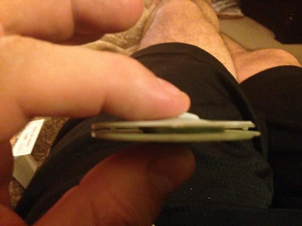

Post by slawton » Thu Sep 25, 2014 3:11 pm
Here's a blurry picture of the LED chaser circuit board on the front of the secondary hull (I was hoping it could sit behind the deflector dish) plus the blinking board inside the primary saucer hull (my first hope that it would fit internally):
In case you were wondering, even though the larger circuit board square is small enough to fit inside the saucer circle, it is too thick (with components on top of the board) to snap the saucer together (even with maximum sanding of the inside):

Post by cannon fodder » Thu Sep 25, 2014 4:43 pm
Only suggestion i have is pit the led's in the model, use zip ties to bundle the wires or tape even, and put the boards in the base.
