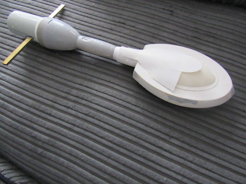

Playing about with some kit parts see if I can get it to look good
Image Image

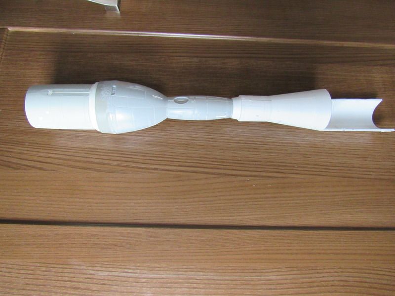

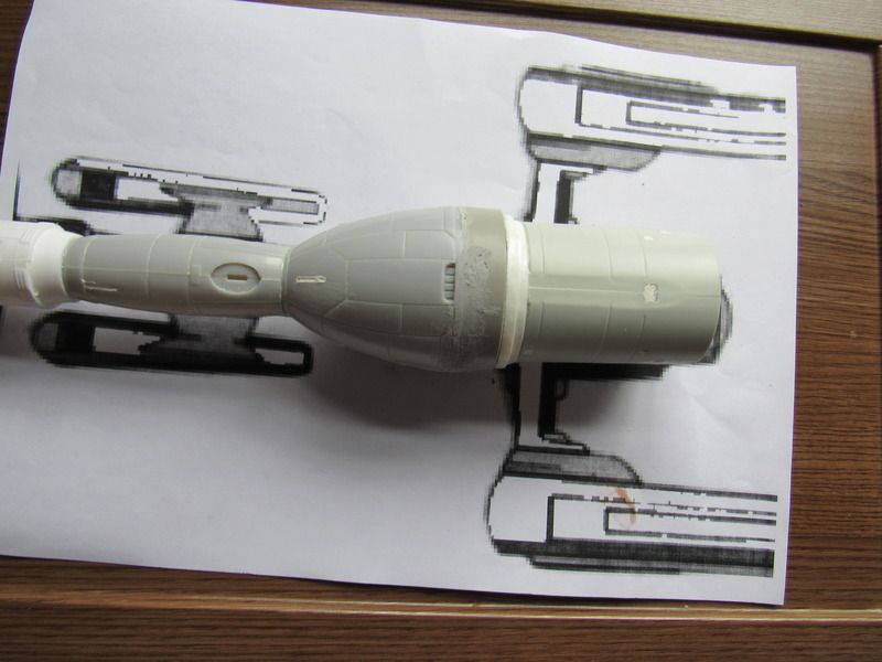

Tail section where engineering lives

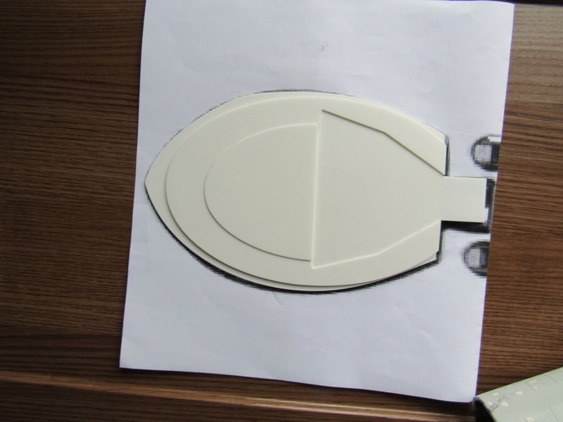

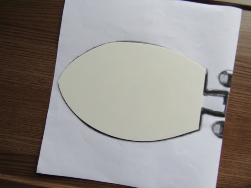

the largest piece of the nose section

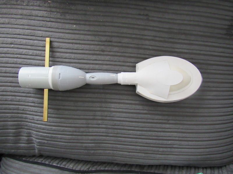

the rough casting for the bridge after much cleaning sanding and shaping of the super structure this ended up fitting better backwards

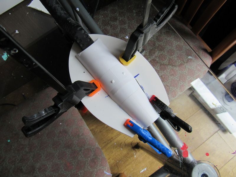

the Nose was attached to the lower bulkhead

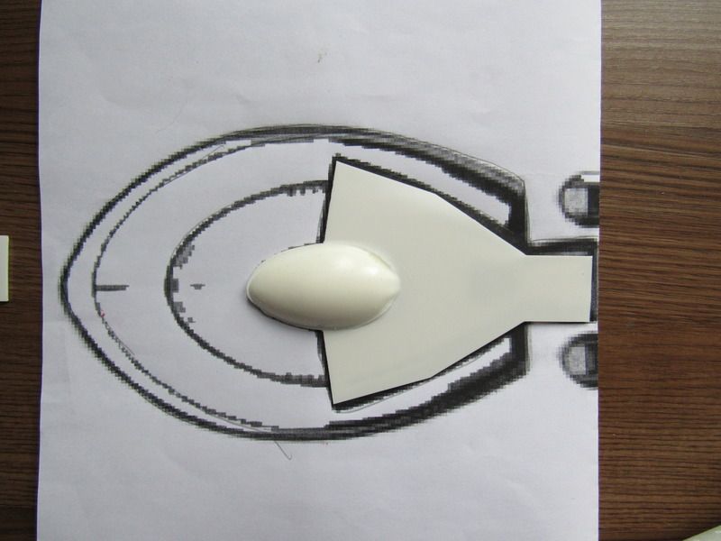

some Plastruct was used as spacer between the top and bottom of the nose section then filler to close it up and shape the curve then a metal beam melted through both sides of the engineering section to mount the nacelles on
a resin cast from a cooking spoon was trimmed to give the curve for the forward structure and sheet styreen cut slightly wider than the flat shape was curved over to form the rear superstructure

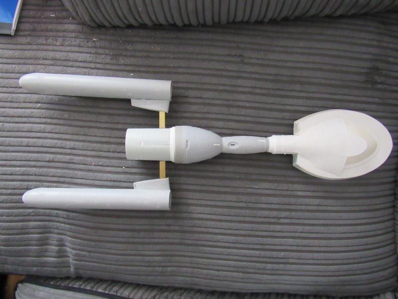

then I melted mount holes in the nacelles and put them on to see how they look

Thanks I'm a bit far away (about 4,500miles) the main bit of scratch building was the nose which I cut the styreen using a silhouette portrait machine to cut 0.74mm sheets. What sort of ideas are you thinking of
